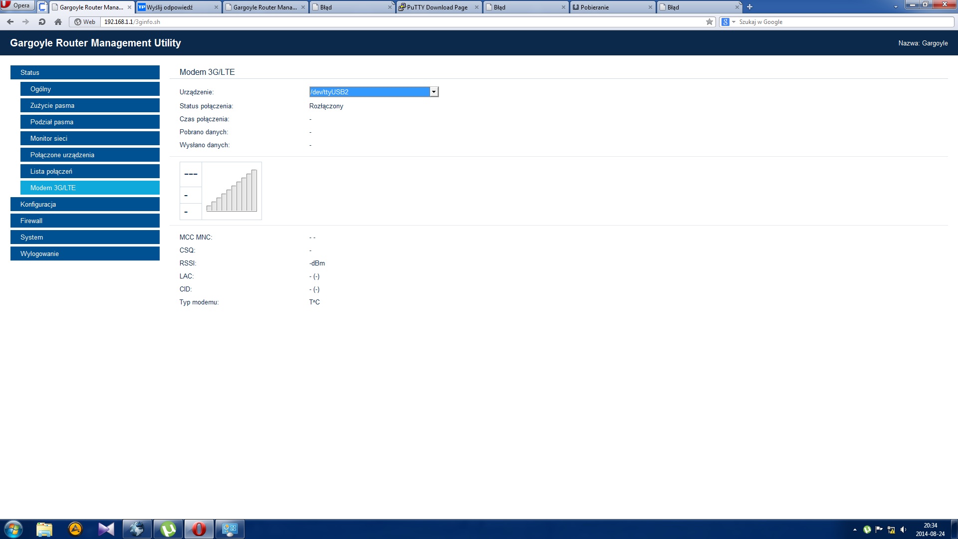

Ustawiłem:
Jednak router nie widzi mojego modemu
Po wciśnięciu "skanuj" ->

Jan  1 01:13:00 Gargoyle daemon.warn httpd_gargoyle[1494]: started as root without requesting chroot(), warning only
Jan  1 01:13:00 Gargoyle daemon.notice httpd_gargoyle[1494]: httpd_gargoyle/1.0 14mar2008 starting on Gargoyle, port 80
Jan  1 01:13:01 Gargoyle user.notice dnsmasq: DNS rebinding protection is active, will discard upstream RFC1918 responses!
Jan  1 01:13:01 Gargoyle user.notice dnsmasq: Allowing 127.0.0.0/8 responses
Jan  1 01:13:01 Gargoyle user.notice dnsmasq: Allowing RFC1918 responses for domain free.aero2.net.pl
Jan  1 01:13:04 Gargoyle daemon.info dnsmasq[1527]: started, version 2.66 cachesize 150
Jan  1 01:13:04 Gargoyle daemon.info dnsmasq[1527]: compile time options: no-IPv6 GNU-getopt no-DBus no-i18n no-IDN DHCP no-DHCPv6 no-Lua TFTP no-conntrack no-ipset no-auth
Jan  1 01:13:04 Gargoyle daemon.info dnsmasq-dhcp[1527]: DHCP, IP range 192.168.1.100 -- 192.168.1.249, lease time 12h
Jan  1 01:13:04 Gargoyle daemon.info dnsmasq[1527]: using local addresses only for domain lan
Jan  1 01:13:04 Gargoyle daemon.info dnsmasq[1527]: reading /tmp/resolv.conf.auto
Jan  1 01:13:04 Gargoyle daemon.warn dnsmasq[1527]: ignoring nameserver 192.168.1.1 - local interface
Jan  1 01:13:04 Gargoyle daemon.info dnsmasq[1527]: read /etc/hosts - 2 addresses
Jan  1 01:13:04 Gargoyle daemon.info dnsmasq-dhcp[1527]: read /etc/ethers - 0 addresses
Jan  1 01:13:05 Gargoyle user.info sysinit: ERROR: No valid dynamic DNS service configurations defined
Jan  1 01:13:05 Gargoyle user.info sysinit: (Did you specify correct configuration file path?)
Jan  1 01:13:05 Gargoyle user.info sysinit: setting up led WAN
Jan  1 01:13:05 Gargoyle user.info sysinit: setting up led LAN1
Jan  1 01:13:05 Gargoyle user.info sysinit: setting up led LAN2
Jan  1 01:13:05 Gargoyle user.info sysinit: setting up led LAN3
Jan  1 01:13:05 Gargoyle user.info sysinit: setting up led LAN4
Jan  1 01:13:05 Gargoyle user.info sysinit: setting up led WLAN
Jan  1 01:13:05 Gargoyle user.info sysinit: setting up led USB
Jan  1 01:13:16 Gargoyle daemon.info dnsmasq-dhcp[1527]: DHCPREQUEST(br-lan) 192.168.1.131 44:8a:5b:28:a3:03
Jan  1 01:13:16 Gargoyle daemon.info dnsmasq-dhcp[1527]: DHCPACK(br-lan) 192.168.1.131 44:8a:5b:28:a3:03 Kuba-Komputer
Jan  1 01:13:20 Gargoyle daemon.info dnsmasq-dhcp[1527]: DHCPINFORM(br-lan) 192.168.1.131 44:8a:5b:28:a3:03
Jan  1 01:13:20 Gargoyle daemon.info dnsmasq-dhcp[1527]: DHCPACK(br-lan) 192.168.1.131 44:8a:5b:28:a3:03 Kuba-Komputer
Jan  1 01:13:39 Gargoyle kern.info kernel: [   95.920000] usb 1-1: new high-speed USB device number 2 using ehci-platform
Jan  1 01:13:39 Gargoyle kern.info kernel: [   96.070000] scsi0 : usb-storage 1-1:1.0
Jan  1 01:13:39 Gargoyle user.notice usb-modeswitch: 1-1:1.0: Manufacturer=D-Link,Inc Product=D-Link_DWM-156 Serial=536591501107810
Jan  1 01:13:40 Gargoyle user.notice usb-modeswitch: 1-1:1.0: Selecting /etc/usb_modeswitch.d/2001:a706 for mode switching
Jan  1 01:13:40 Gargoyle syslog.notice usb_modeswitch: switch device 2001:a706 on 001/002
Jan  1 01:13:40 Gargoyle kern.warn kernel: [   96.550000] usb 1-1: usbfs: process 1836 (usb_modeswitch) did not claim interface 0 before use
Jan  1 01:13:40 Gargoyle kern.info kernel: [   96.560000] usb 1-1: USB disconnect, device number 2
Jan  1 01:13:41 Gargoyle kern.info kernel: [   97.380000] usb 1-1: new high-speed USB device number 3 using ehci-platform
Jan  1 01:13:41 Gargoyle kern.info kernel: [   97.540000] scsi1 : usb-storage 1-1:1.6
Jan  1 01:13:41 Gargoyle user.notice usb-modeswitch: 1-1:1.0: Manufacturer=D-Link,Inc Product=D-Link_DWM-156 Serial=?
Jan  1 01:13:41 Gargoyle user.notice usb-modeswitch: 1-1:1.1: Manufacturer=D-Link,Inc Product=D-Link_DWM-156 Serial=?
Jan  1 01:13:42 Gargoyle user.notice usb-modeswitch: 1-1:1.2: Manufacturer=D-Link,Inc Product=D-Link_DWM-156 Serial=?
Jan  1 01:13:42 Gargoyle user.notice usb-modeswitch: 1-1:1.3: Manufacturer=D-Link,Inc Product=D-Link_DWM-156 Serial=?
Jan  1 01:13:42 Gargoyle user.notice usb-modeswitch: 1-1:1.4: Manufacturer=D-Link,Inc Product=D-Link_DWM-156 Serial=?
Jan  1 01:13:42 Gargoyle kern.notice kernel: [   98.540000] scsi 1:0:0:0: Direct-Access     HSPA USB SCSI CD-ROM      6225 PQ: 0 ANSI: 0 CCS
Jan  1 01:13:42 Gargoyle kern.notice kernel: [   98.550000] sd 1:0:0:0: [sda] Attached SCSI removable disk
Jan  1 01:13:42 Gargoyle user.notice usb-modeswitch: 1-1:1.5: Manufacturer=D-Link,Inc Product=D-Link_DWM-156 Serial=?
Jan  1 01:13:42 Gargoyle user.notice usb-modeswitch: 1-1:1.6: Manufacturer=D-Link,Inc Product=D-Link_DWM-156 Serial=?
Jan  1 01:14:24 Gargoyle daemon.info dnsmasq-dhcp[1527]: DHCPINFORM(br-lan) 192.168.1.131 44:8a:5b:28:a3:03
Jan  1 01:14:24 Gargoyle daemon.info dnsmasq-dhcp[1527]: DHCPACK(br-lan) 192.168.1.131 44:8a:5b:28:a3:03 Kuba-Komputer
Success
Twój modem jest trochę problematyczny ale można go ustawić.
Pierwsza rzecz to edycja pliku /etc/hotplug.d/usb/20-modeswitch
należy dodać linię: sleep 3
tak aby plik wyglądał tak:
#!/bin/sh
local uVid uPid uMa uPr uSe
local sVe sMo sRe
local modeswitch="/usr/bin/usb_modeswitch"
log() {
        logger -t "usb-modeswitch" "$@"
sleep 3
sanitize() {
        sed -e 's/[[:space:]]\+$//; s/[[:space:]]\+/_/g' "$@"
##i wiele więcej###
następnie wydać polecenie w konsoli:
echo "07d1 7e11" > /sys/bus/usb-serial/drivers/option1/new_id
Po restarcie modem powinien być wykrywany prawidłowo.
Mam krótkie pytanie
Gdzie jest konsola? :slight_smile:
drugie: W co ja mam wejść tak w ogóle? Tzn. Gdzie?
Bardzo proszę jak dla laika...
Mam przez PuTTy wejść do routera?
ojoj to proste nie będzie. PRZECZYTAJ 2 RAZY zanim zaczniesz.
Konsola dostępna jest przez ssh i można tam się dostać za pomocą programu putty.
z wydaniem polecenia problemu nie będzie bo wystarczy je wkleić ( kliknąć prawym przyciskiem myszy)
Trudniej wyedytować plik.
jeśli się nie pomylisz i wykonasz wg instrukcji to dasz radę, to co jest w znacznikach code to wykonujesz na konsoli reszta to komentarze:
uruchom putty i w polu hostname wpisz ip 192.168.1.1 , zaznacz SSH i kliknij OPEN
w putty wklej polecenie:
vi /etc/hotplug.d/usb/20-modeswitch
teraz otworzył się edytor vi i w nim nic nie wyklikasz jedynie obsługa klawiszami więc naciskaj dokładnie tyle razy dany klawisz ile napiszę:
{naciśnij 11 razy strzałkę w dół}
{naciśnij o}
{wpisz: sleep 3}
{naciśnij ENTER}
{naciśnij ESC}
{naciśnij :(dwukropek)}
{wpisz !wq(wykrzyknik,w,q)}
Jeśli się pomylisz to najłatwiej zrestartować i zacząć wpisywać ponownie lub przycisnąć ESC i wpisać :q! wtedy opuścisz edytor bez zapisywania zmian.
Dalej to samo. :smiley:
Załączam logi z routera:

Opiszę po kolei co zrobiłem:
W putty wpisałem adres 192.168.1.1, zaznaczyłem opcję ssh, kliknąłem open
zalogowałem się jako "root" hasło "admin"
Do wiersza z zielonym napisem "root@Gargoyle:~# wkleiłem echo "07d1 7e11" > /sys/bus/usb-serial/drivers/option1/new_id i zatwierdziłem enterem
Następnie wkleiłem vi /etc/hotplug.d/usb/20-modeswitch i zatwierdziłem enterem. Otworzył się edytor vi i wykonałem czynności jak mówiłeś, przynajmniej mam taką nadzieję.
W każdym razie dopisek "sleep3" w tym pliku jest, co udowadniam screenem, może na nim ktoś wypatrzy jakiś mój błąd, bo nie dam sobie głowy uciąć, że po drodze coś nie namieszałem:
Gdzie tkwi feler?

Tutaj w polu urządzenie:
Po kliknięciu "skanuj" Mam rozwijaną listę i do wyboru sześć urządzeń od 0 do 5 (/dev/ttyUSB0 do ttyUSB5)
Mogę sobie je wybrać, zapisać zmiany i w sumie tyle.
Tutaj:
Mam podobną listę, lecz status na każdym jest "rozłączony" i w każdym polu (czas połączenia, pobieranie danych itd. do samego dołu) są kreski
Po wybraniu każdego urządzenia przez chwilę ok 5-15sek mam ciemnoniebieski ekran "pobieranie danych". I niestety tyle. Status jest "rozłączony" i nic nie jest aktywne. Brakuje mi jeszcze takiego wielkiego przycisku "POŁĄCZ"
Co zaobserwowałem: Jedynie po wybraniu urządzenia /dev/ttyUSB2 mam cokolwiek napisane w polu "typ modemu" Jednak moim zdaniem są to zupełnie losowe znaki i za każdym razem inne i w różnej ilości...
Narazie nie używaj opcji Modem 3G/LTE. zajmij się stroną konfiguracji. tam wybieraj port i klikaj zapisz ustawienia.
Przeleciałem wszystkie po kolei, zapisałem i nic. Brak odzewu- internetu brak.
(cały czas jestem podłączony kablem do routera z komputera stacjonarnego o ile to ma jakieś znaczenie)
