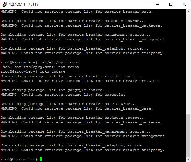

Pokaż wynik z komendy: cat /etc/opkg.conf
nie mam dostępu jedyny aktualny dostęp to właśnie ten HiLink który chce zainstalować.
cat /etc/opkg.conf not found

Co dostałeś po pierwszym wpisie:
gpgk update
gpkg install opkg

root@Gargoyle:~# gpkg update
Downloading package list for barrier_breaker_routing source...
WARNING: Could not retrieve package list for barrier_breaker_routing.
Downloading package list for gargoyle source...
WARNING: Could not retrieve package list for gargoyle.
Downloading package list for barrier_breaker_base source...
WARNING: Could not retrieve package list for barrier_breaker_base.
Downloading package list for barrier_breaker_packages source...
WARNING: Could not retrieve package list for barrier_breaker_packages.
Downloading package list for barrier_breaker_management source...
WARNING: Could not retrieve package list for barrier_breaker_management.
Downloading package list for barrier_breaker_telephony source...
WARNING: Could not retrieve package list for barrier_breaker_telephony.
root@Gargoyle:~# gpkg install opkg
ERROR: No package named opkg found, try updating your package lists
